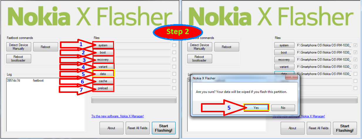

1... Unzip Download file.
2... Open flash tool.
3... Connect your phone fastboot mode(click volum down and power key same time.)
4... Connect your phone on pc using data cable.
5... Select all File link video.
6... Click flashing start.
7... Few mins waiting flashing process.
8... Flashing complite rebot tab cliack.now your phone rebot normal mode.
9... Flashing complite.
