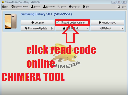

GOOD DAY MGA TOL SHARE KU LANG SA INYO ETO Samsung Galaxy S8+ G955F MAG PA UNLOCK DONE SA CHIMEA TOOL
PAKI SUNDAN NALANG MGA KOL
KALTAS SA CREDITS 59
YAN TAPOS NA ENTER NA SA PHONE ANG CODE
WALANG PIC CP NAG MADALI TUMER KO

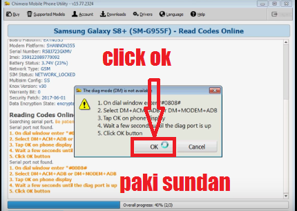

Searching serial port. Be patient! Do NOT disconnect the phone!
Serial port not found.
1. On dial window enter *#0808# 2. Select DM+ACM+ADB or DM+MODEM+ADB 3. Tap OK on phone display 4. Wait a few seconds until the diag port is up 5. Click OK button
Serial port found on COM54

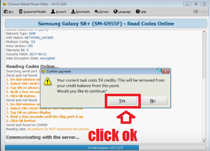

Reading data. Be patient! Do NOT disconnect the phone!
Communicating with the server...
Waiting for the server to respond.
This operation costed 59 credits.

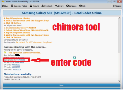

Master Lock: 15263596
Network Lock: 06908303
Subset Lock: 00000000
SP Lock: 00000000
CP Lock: 00000000
SIM Lock: 00000000
Finished successfully.
