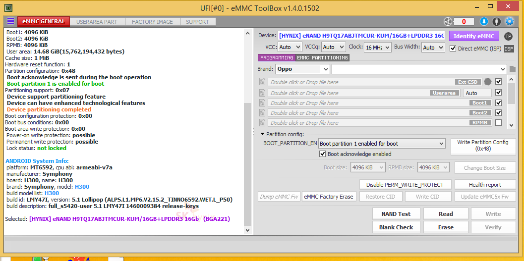

ANDROID System Info:
platform: MT6592, cpu abi: armeabi-v7a
manufacturer: Symphony
board: H300, name: H300
brand: Symphony, model: H300
build model list: H300
build id: LMY47I, version: 5.1 Lollipop (ALPS.L1.MP6.V2.15.2_TINNO6592.WET.L_P50)
build description: full_s5420-user 5.1 LMY47I 1460009384 release-keys

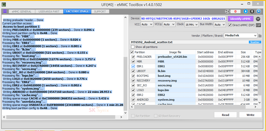

Selected: [HYNIX] eNAND H9TQ17ABJTMCUR-KUM/16GB+LPDDR3 16Gb (BGA221)
Writing preloader header... Done
Current partition access:
Access to boot partition 1
Writing PRELOADER at 0x00000000 (239 sectors)... Done in 0.096 s
Writing boot partition config to 0x48... Done
Processing file: "MBR"...
Writing MBR at 0x00000000 (1 sectors)... Done in 0.026 s
Processing file: "EBR1"...
Writing EBR1 at 0x00080000 (1 sectors)... Done in 0.001 s
Processing file: "lk.bin"...
Writing UBOOT at 0x01D40000 (521 sectors)... Done in 0.155 s
Processing file: "boot.img"...
Writing BOOTIMG at 0x01DA0000 (12776 sectors)... Done in 3.757 s
Processing file: "recovery.img"...
Writing RECOVERY at 0x027A0000 (14456 sectors)... Done in 4.247 s
Processing file: "secro.img"...
Writing SEC_RO at 0x031A0000 (264 sectors)... Done in 0.080 s
Processing file: "logo.bin"...
Writing LOGO at 0x03820000 (2650 sectors)... Done in 0.776 s
Processing file: "EBR2"...
Writing EBR2 at 0x04020000 (1 sectors)... Done in 0.002 s
Processing file: "system.img"...
Writing ANDROID at 0x05000000 (4547160 sectors)... Done in 22 mins 28.953 s
Processing file: "cache.img"...
Writing sparse image CACHE at 0xC5000000 (868352 sectors)... Done in 5.432 s
Processing file: "userdata.img"...
Writing sparse image USRDATA at 0xDF800000 (23418880 sectors)... Done in 1 min 21.284 s
